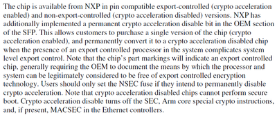

I am using the LS1028A processor in a new project. We need to generate/validate CRCs very quickly. I have seen that the security engine (SEC) can be used to do this.
My concern is that we will be supporting customers that require encryption to be disabled because to US export laws. The part number of the processor specifies if encryption is enabled or disabled.
Would we be able to use the SEC to generate/validate CRCs on processor's with encryption turned off?

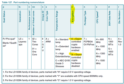

By saying encryption enabled and disable, which of the following cases are you referring to?
1. "E" part and "non-E" part
2. "E" part with crypto acceleration disabled via register SFP_OSPR0[NSEC] bit.
For case #1, it is not possible to use SEC on a "non-E" part, as SEC is completely power gated on such parts.
For case #2, you can enable and disable SEC with OEM Security Policy Register 0 (SFP_OSPR0) for export control, if you are using "E" part.
Ran

We are concerned with export control, so bullet 2 is the applicable scenario.
So we are able to render the part exportable and retain the CRC engine by burning a fuse. This is good news.
