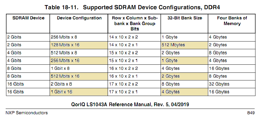

Using LS1023A with 2 chips 16bit DDR4?

Here 32-bit bank means using 2 chips 16bit DDR with LS1023A

kmh1528
Thank you for your help in designing.
