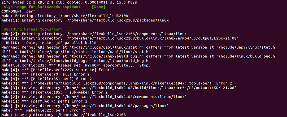

I compile linux kernel on ubuntu2004, using the following command:
flex-builder -c linux
and then ,
flex-builder -i  mkboot
but get following errors:

Please install python-devel. It's need for the perf tool when building the kernel.
$ sudo apt-get install -y python-dev
