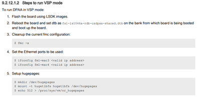

In Bootloader i have updated the device-tree as per LSDKUG_21.08
sakthi_mgtech_0-1658750236885.pngsakthi_mgtech_0-1658750236885.pngsakthi_mgtech_1-1658750267638.pngsakthi_mgtech_1-1658750267638.png
As per the document i have done all the setting and it was working fine. I was able to receive UDP/ESP traffic in DPDK(l2fwd) and rest of all traffic in kernel.

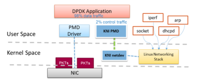

Typically, DPDK PMD receives all the traffic.
DPDK Application may registers a virtual/logical ethernet interface in kernel netdev for each
physical interface it own.Based on the application logic, it sends the linux host bound traffic to Linux networking stack using this interface
I have tested kni also as per this link http://doc.dpdk.org/guides-20.11/sample_app_ug/kernel_nic_interface.html
DPDK KNI is working fine but i need to run DPDK application for packet processing/encryption/decryption/kni in single application, typically kni+dpdk-l2fwd-crypto or kni+dpdk-ipsec-secgw, is possible to integrate these two application in single application, I am fresher to DPDK can you guide me to integrate this applications or suggest alternate plan to achieve DPDK linux networking.

I checked the configurations file from customer, it seems customer used transport mode.
Can customer try ipsecgw with tunnel mode?
or they only need transport mode?
