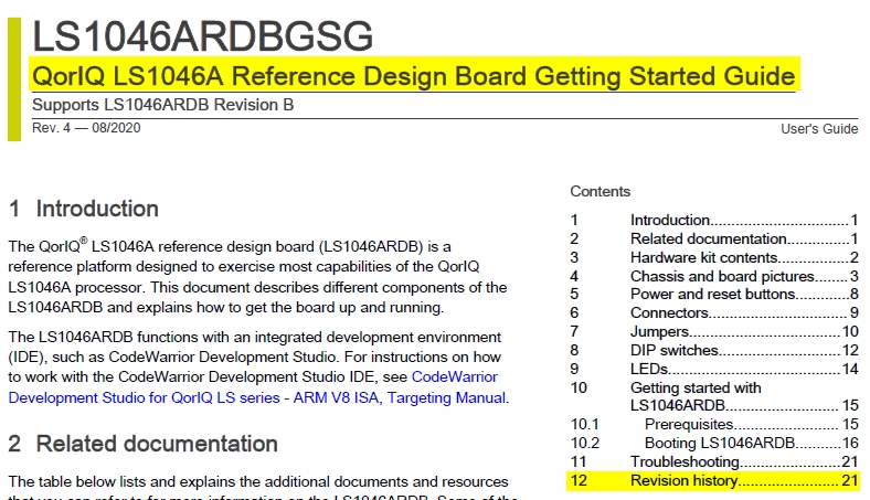

I'm sorry. It seems that you refer to this document, but I can't see chapter 14 (neither the number nor anything about "Configuring U-Boot environment variables"). Am I wrong with the document?
5,094件の閲覧回数
ufedor
I've referred an ancient version of the GSG - attached.
5,145件の閲覧回数
ufedor
To transfer files it is needed to configure Ethernet environment variables and use TFTP - refer to the LS1046A Reference Design Board Getting Started Guide available here:
https://www.nxp.com/design/qoriq-developer-resources/layerscape-ls1046a-reference-design-board:LS104...
