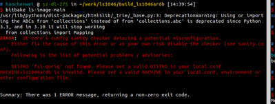

I have tried to pull yocto project repo according to the NXP Layerscape latest user  guide from https://www.nxp.com/docs/en/user-guide/LLDPUG_RevL6.1.22_2.0.0.pdf
(Refer to the section 4.5.2 Download Yocto bitbake)
The bitbake returns the error outlined below:
``` Log
DISTRO 'fsl-qoriq' not found. Please set a valid DISTRO in your local.conf
MACHINE=ls1046ardb is invalid. Please set a valid MACHINE in your local.conf, environment or other configuration file.
Any solution can be provided to me?
1,743 Views
Irene
NXP Pro Support
NXP Pro Support
Before you executed, bitbake ls-image-main did you execute DISTRO=fsl-qoriq-distro MACHINE=<machine> source distro-setup-env for the specific board that you are using?
1,724 Views
haochenwei
The root cause is that the `oh-my-bash` is used in my Ubuntu console. it worked when I changed to raw bash.
