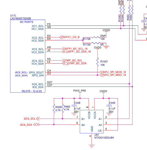

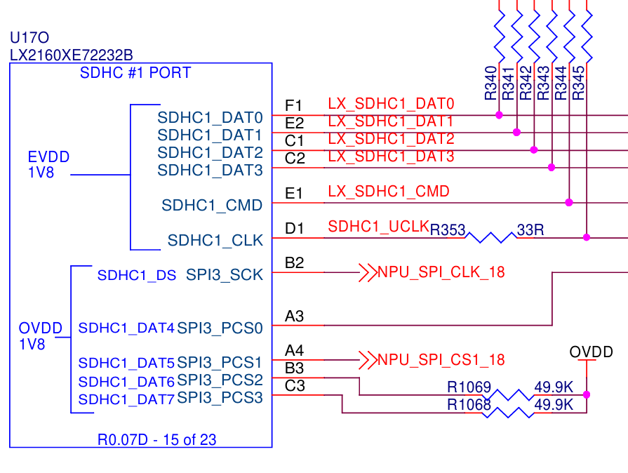

RCW Fields.
IIC5_PMUX=3
SDHC1_DIR_PMUX=3
SDHC1_DS_PMUX=2
Please Note: CLK, MOSI are generated correctly but CS isn't working the same.
SPI3_SOUT i.e. SPI 3 is used in the board.

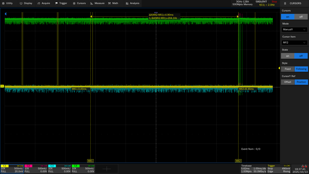

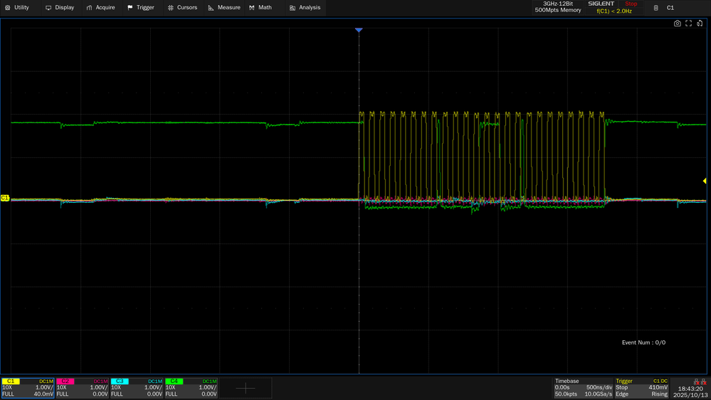

The Yellow is Chip select, Green Data(MOSI), Pink Clock and Blue DIO (MISO)
This is a zoomed out image to show the time gap between Chip select Going low and the Incoming Data
Zoomed in version green as MOSI and yellow as Clock.
why is SPI driver is generating so much delay between CS-CLK.

SDHC1_DS_PMUX configuration:
Configures the functionality on SDHC1_DS
0b00 - SDHC1_DS
0b01 - GPIO_4[29]
0b10 - SPI3_SCK
0b11 - Reserved
SDHC1 and SPI3 cannot work at the same time.
在原帖中查看解决方案

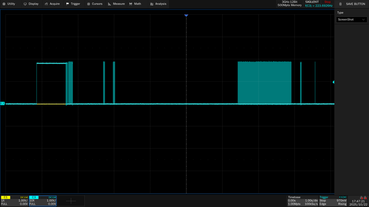

shivam_kumar
Hey Mr Wang,
We have made the changes and still the SPI behaves the same way
here is a screen shot from PCS1
scale:- 1s/div
this is the full capture from Power on -> Uboot
thank you
