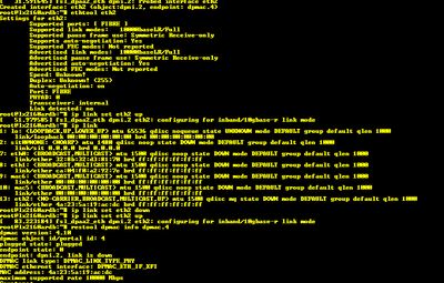

We're in the middle of bringing up a custom LS1046A-based board and we've gotten far enough to boot into Linux successfully (using lsdk2108_yocto_tiny_LS_arm64.itb).
The problem we're facing currently is that SFP modules will not establish a link with the switch, but only in Linux, in u-boot, it works fine.
Here's the output:

As you can see, both modules that are inserted are correctly detected, no issues reported on any of the interfaces either, if I bring them up, they work fine:
root@TinyLinux:~# ip link set fm1-mac9 up
[   14.332682] fsl_dpaa_mac 1af0000.ethernet fm1-mac9: configuring for inband/10gbase-kr link mode
root@TinyLinux:~# ip link set fm1-mac10 up
[   19.500673] fsl_dpaa_mac 1af2000.ethernet fm1-mac10: configuring for inband/10gbase-kr link mode
root@TinyLinux:~# ip a
1: lo: <LOOPBACK,UP,LOWER_UP> mtu 65536 qdisc noqueue qlen 1000
    link/loopback 00:00:00:00:00:00 brd 00:00:00:00:00:00
    inet 127.0.0.1/8 scope host lo
       valid_lft forever preferred_lft forever
2: fm1-mac2: <BROADCAST,MULTICAST> mtu 1500 qdisc noop qlen 1000
    link/ether 00:04:9f:08:06:4a brd ff:ff:ff:ff:ff:ff
3: fm1-mac5: <BROADCAST,MULTICAST> mtu 1500 qdisc noop qlen 1000
    link/ether 00:04:9f:08:06:4b brd ff:ff:ff:ff:ff:ff
4: fm1-mac6: <BROADCAST,MULTICAST> mtu 1500 qdisc noop qlen 1000
    link/ether 00:04:9f:08:06:4c brd ff:ff:ff:ff:ff:ff
5: fm1-mac9: <NO-CARRIER,BROADCAST,MULTICAST,UP> mtu 1500 qdisc mq qlen 1000
    link/ether 00:04:9f:08:06:4d brd ff:ff:ff:ff:ff:ff
6: fm1-mac10: <NO-CARRIER,BROADCAST,MULTICAST,UP> mtu 1500 qdisc mq qlen 1000
    link/ether 00:04:9f:08:06:4e brd ff:ff:ff:ff:ff:ff
I don't understand why no-carrier, regardless which mode I try in the device tree, I've tried xfi, xsgmii, 10gbase-r, nothing works.
Please advise.

tzaman
For posterity; We fixed the issue, turns out that we forgot to configure RCW for the pin that was driving our clock mux low, which fed 100 Mhz clock into the Serdes reference clock input, rather than 156.25 MHz that it needs. After we fixed RCW, everything started to work properly.
