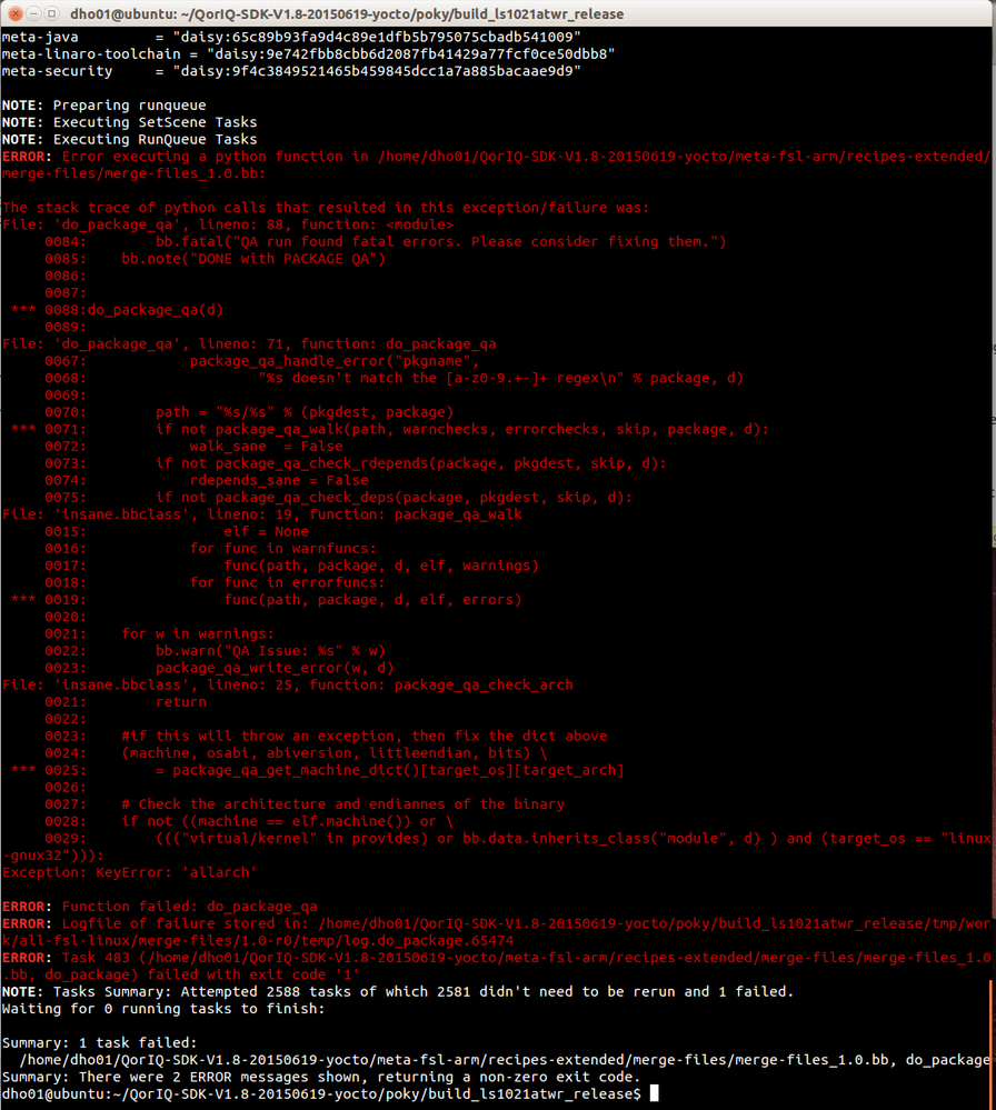

Thank you for replying Yiping, I did everything that you said to, but I ran into an error with the bitbake fsl-image-core command. I am running QorIQ SDK v1.8 and merge-files_1.0.bb (under recipes-extended/mergefiles) was throwing exceptions after I created all the folders and ran bitbake. I changed the maxdepth and mindepth to 4 to remove the exception that was thrown (they were both previously 1). I got the .elf file from CodeWarrior v10.0.7 for ARM v7.
After I programmed the ramdisk image into the board through u-boot and tftp, the board didn't have the .elf file anywhere. Instead the board just booted up like it did before, without any of the files from the merge-files folder.

datho
Here's a screenshot of the error I encountered before editing merge-files_1.0.bb:Screenshot from 2016-01-08 14_41_28.png

yipingwang
Hello Dat Ho,
No need to modify merge-files recipe, this package is just for users to add their own files.
Please refer to my merge-files folder in meta-fsl-arm/recipes-extended/merge-files/, which I have verified in SDK 1.8 environment.

datho
Your merge-files folder did work when I ran bitbake. The error I ran into only occurs when I try to add my own UDP.elf file from codewarrior. I noticed that one of the major differences between my UDP.elf file and the one you provided was that Ubuntu recognized your UDP.elf as a text based file and my UDP.elf file as an executable file. Have you been able to successfully bitbake a .elf file with executable code from a Codewarrior 10.0.7 Arm v7 Linux Application project?

yipingwang
Hello Dat Ho,
Please use the attached recipe to replace meta-fsl-arm/recipes-extended/merge-files/merge-files_1.0.bb, run "bitbake merge-files -c cleansstate", then build your rootfs filesystem.
Yiping
5,714 Views
datho
Using this .bb file, I'm able to add my own .elf and .cfg files to the RAM of the board. Thank you very much for guiding me to this point.
