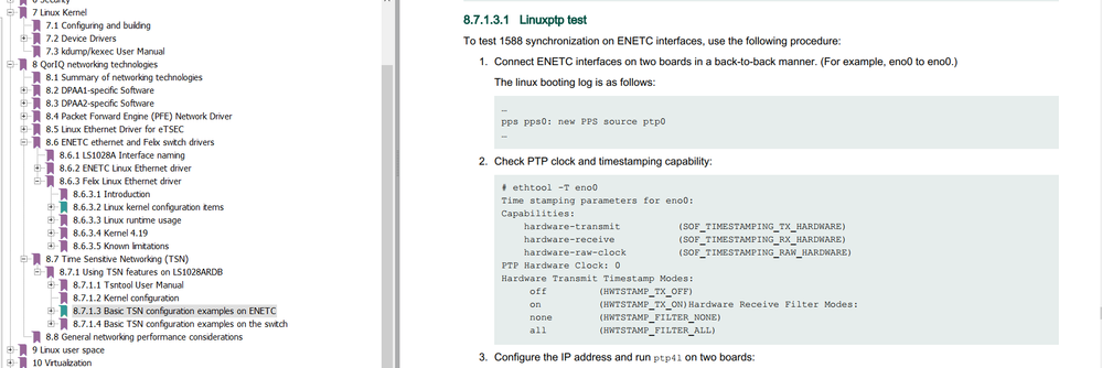

Refer to LSDKUG_Rev20.04_290520.pdf for the following operations, but the same result cannot be obtained。
All application components have been compiled into the file system。
How to start tsn network using lsdk2004 on ls1028ardb, what configuration needs to be done on the kernel.

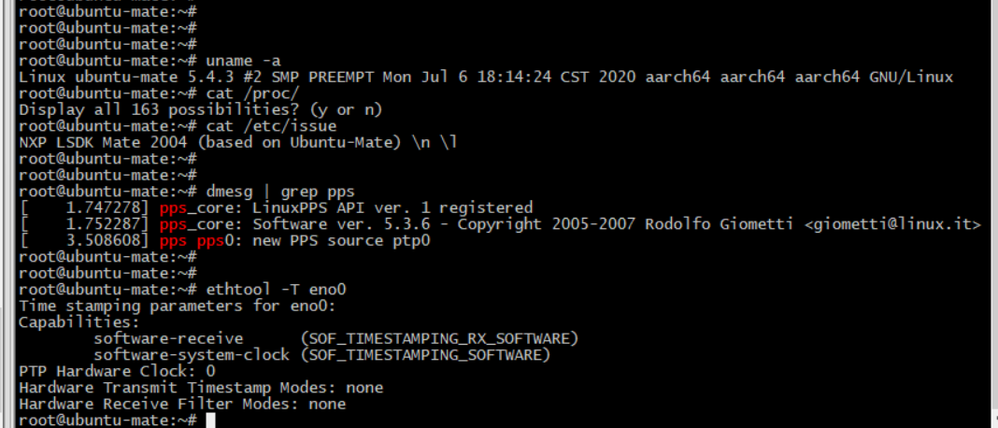

Based on your console outputs, your kernel is missing FSL_ENETC_HW_TIMESTAMPING option. Make sure this option is
set to "Y" and rebuild. See LSDK UM Section 8.7.1.2 for more information.
