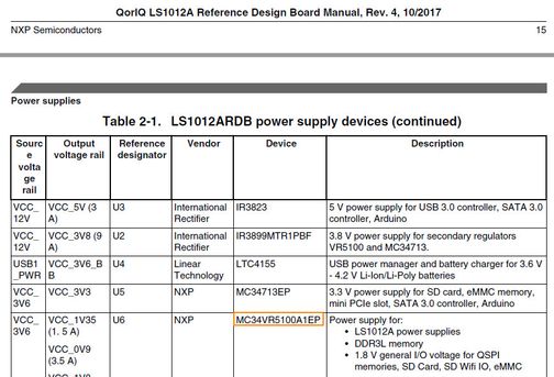

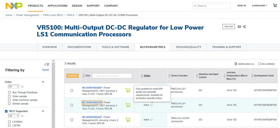

ufedor
> VR5100 however it has gone obsolete
This is the PMIC used on the LS1012ARDB:
Product:
https://www.nxp.com/products/power-management/pmics-and-sbcs/pmics/multi-output-dc-dc-regulator-for-...
