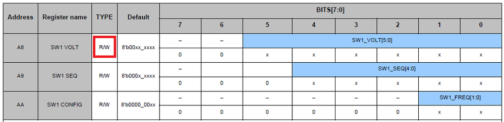

I used the 34VR500 (V1) as PMIC for my LS1 design which worked so far really well.
Now we faced an issue during the really early boot-up of the module and I tried to adjust the sequencing of the PMIC to get rid of the issue. Long story short I'm not able to program the internal RAM of the PMIC.
Question #1:
Why is the internal user space carry out as RAM? This makes it necessary to write the new setup every time after a rest ... that's true?
Question #2:
How it should work? In Figure 7 of the datasheet, you can see that the programming needs to be done before the enable pin becomes a release. So how this should work? If the PMIC isn't alive the LS1 isn't alive too, how should program the PMIC ... a second controller?
Question #3:
I got the feedback from EBV that there isn't s Spezial sequencing needed and it would be possible to write to the internal RAM at any time. I tried it in different configurations and I never was able to read any value back from the internal RAM.
Question #4:
The description of the internal RAM register is really poor, is there a detailed description available?
Best regards and thank you in advance
Ch. Sielaff

My first questions were why the user configuration space where carry out as RAM? I know that the 34VR500 are available in 12 different pre-configured versions that's not the question. The PMIC has the possibility to adjust the sequencing ... but if this user adjustment is stored in a volatile memory what benefit I can gain here for my design?
To question #2:
So this means the feature is unusable ... or? Because if powered device which cannot accept the hard-coded configuration cannot reprogram it. An unpowered device that accepts the configuration can reprogram it or what? What's the use case here?
To question #3:
I can read all the registers of the PMIC even when I keep them at rest. So the I2C communication works fine. But it does not matter what I write in the RAM area I always read 0x00 back.
To question #4:
Thanks for the latest version of the datasheet but even in this version the RAM registers are poorly described! For example, I can't find the description of Reg 0xE0 - "PU CONFIG1" or reg 0xE8 - "PWRGD EN". That's unacceptable for a datasheet in revision 12.
