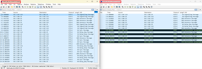

Hi NXP team:
When LX2160A/LX2080A initialize DPDK from test.sh script for out application, PTP function can't work.
In this condition, can LX2160A can use PTP function?
If we want to use PTP, kernel stack and DPDK on single Ethernet port , how to configure DPDK correctly?
Please refer to console log below and attachment file.(Initial DPDK script)

root@localhost:~# ptp4l -H -s -m -i eth0 --tx_timestamp_timeout=20 -f G.8275.2.cfg
ptp4l[240.582]: selected /dev/ptp0 as PTP clock
ptp4l[240.582]: port 0: hybrid_e2e only works with E2E
ptp4l[240.601]: port 1: INITIALIZING to LISTENING on INIT_COMPLETE
ptp4l[240.604]: port 0: INITIALIZING to LISTENING on INIT_COMPLETE
ptp4l[246.375]: selected local clock 807871.fffe.12c429 as best master
ptp4l[247.006]: port 1: new foreign master 000580.fffe.07f653-5
ptp4l[250.999]: selected best master clock 000580.fffe.07f653
ptp4l[250.999]: updating UTC offset to 37
ptp4l[250.999]: port 1: LISTENING to UNCALIBRATED on RS_SLAVE
ptp4l[254.294]: master offset -863600868970450888 s0 freq -441 path delay 863600868970456647
ptp4l[255.292]: master offset -863600868970450768 s1 freq -321 path delay 863600868970456647
ptp4l[256.291]: master offset -1089 s2 freq -1410 path delay 863600868970456647
ptp4l[256.291]: port 1: UNCALIBRATED to SLAVE on MASTER_CLOCK_SELECTED
ptp4l[257.289]: master offset -431800435712170306 s2 freq -249999999 path delay 1295401304682627354
ptp4l[258.287]: master offset -431800435707937952 s2 freq -249999999 path delay 1295401304682627354
ptp4l[259.286]: master offset -431800435806817514 s2 freq -249999999 path delay 1295401304785740265
ptp4l[260.284]: master offset -431800435905697073 s2 freq -249999999 path delay 1295401304888853177

allenwu622
Hi @SebastianG :
PTP can work before initialize DPDK from test.sh.
PTP function test LSDK20.04, LSDK2108, LLDP5.15 and LLDP6.1 that can't work correctly with DPDK.
Please refer to linker below:
https://community.nxp.com/t5/QorIQ/1588-and-DPDK/m-p/1174969/highlight/true
we want that single Ethernet port to use PTP from kernel stack and our applications from DPDK.
Can LX2160A/LX2080A support above application? How to do it?
Or this condition only use PTP from DPDK?
Thanks.

allenwu622
Hi @SebastianG :
I have followed your document to test DPDK and PTP.
The example used two Ethernet port, I change command to test single Ethernet port for our application request, but the result still fail. how to run dpdk-pkt_split_app on single Ethernet port correctly? More detail refer to attachment file.
In this case, LX2160A should been used DPDK and kernel stack for PTP application.
But ptp is different test result between DPDK and non-DPDK in same condition, please refer to picture below, PTP seem packets rules change that cause this issue.
Thanks.
