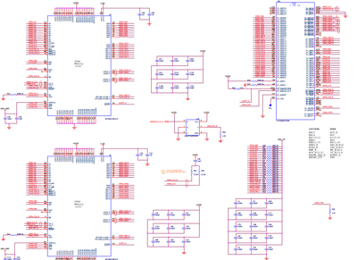

Let me explain our hardward.
We developped the LS1043A custom board with two DDR4 ICs.
It worked find with 2GB DDR4 (2x MT40A512M16 of Micron).
We just changed the DDR4 ICs from MT40A512M16 to MT40A1G16 in the same board,
but failed to bring up our board with 4GB DRAM.
I Successfully brought up new board with 2GB firmware and just notice that DRAM is 2GB
So, I tried to detect 4GB DDR4 in u-boot and kernel.
Here is the schematic of DDR4 area of our board.
I will really appreciate for any advice or help...
Thank you,
