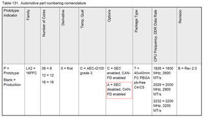

How to disable the secure boot mode on the LX2080 through hardware and software
1,028件の閲覧回数
June_Lu
LX2080CA72232B, you could check the LX2160 Data Sheet, A, SEC disabled, SEC including secure boot. How do you know you enable the secure boot?
3 返答(返信)
1,029件の閲覧回数
June_Lu
1,046件の閲覧回数
June_Lu
Please kindly provide your LX2080 part number.
1,035件の閲覧回数
YY2410
LX2080CA72232B
