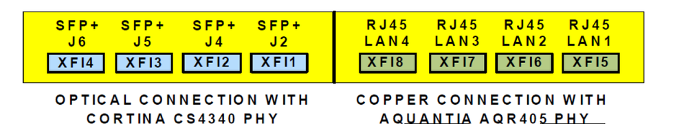

On LS2085ARDB, dpmac.1-dpmac.4 map XFI1-XFI4(SFPJ2-SFPJ6), dpmac.5 is XFI5(RJ45LAN1) and dpmac.7 is XFI7(RJ45LAN3), the connection between DPNI and DPMAC is defined by restool or in the DPL file.
Please check whether your target board is pre-loaded with the DPL file which allocates "dprc.1" with the following command, because in script dynamic_dpl.sh, a child resource container is created dynamically for NADK based on the parent resource container "dprc.1".

Could you look at my picture please ? I'm not sure to understand the the mapping between dpmac and the physical interfaces. I used dpni-0 and dpni-5 because first, I would like to try with a RJ45 cable.
./odp_l2fwd -c 2 -m 0 -i dpni-0,dpni-5

yipingwang
Hello nicolaskury,
I checked your picture and the console log.
On the target board dpmac.5 is ETH0 and dpmac.7 is ETH2, please change to use the correct networking interfaces and check whether there would be any progress.
Please refer to the following from Linux SDK document.
Yiping

nicolaskury
Thanks for your prompt reply.
It seems working ! It was really a dummy issue! The LS2085 was connected to a HP switch and the ports in the switch stayed down (no idea why). When I connect the board directly to a computer that generates traffic, it works.
Now I know that ODP works and what is the relation between dpmac and the physical ports, I'm going to test the througput at 10Gb/s with a Spirent equipment.
Thank you for everything. I let you know if I succeed in doing the measures.
