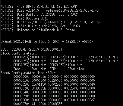

we are having a DDR4 size problem on LS1088a platform.  We have 4GB DDR4 on the board. When u-boot starts it is confirmed that board has 4GB DDR4. But when we checked on kernel with free commands, it shows that RAM is 2GB.  I was delete the "mcmemsize" variable from my U-Boot configuration. Do you have any idea why are we having mismatch DDR size in u-boot and kernel ?
Attached photos you can see the differences.

The lost DDR can be divided into 2 parts.
1) DDR used by NXP specific software, firmware components
2) DDR used by various segments of kernel.
For the first part,
1) u-boot uses memory till it is used, but once kernel boots, u-boot is swapped out of memory.
2) 66 MB is used by TF-A
3) MC can use anywhere between 512M to 2G (it depends on u-boot comandline argument 'mcmemsize'). The parameter mcmemsize defines amount of system DDR to be used by the Management Complex. If this variable is not defined, the compile-time value 0x70000000 or 1.75GB will be the default. Normally, users do not need to set this variable because the default is acceptable.
TF-A+MC is about 1.8G
kernel reserved=(18620K kernel code, 2476K rwdata, 8844K rodata, 5888K init, 993K bss, 406712K reserved, 327680K cma-reserved) = 771213K=0.7G
MemTotal in /proc/meminfo is 14232028 kB, the lost memory is about 16-13.6=2.4G(TF-A+MC+kernel reserved)
