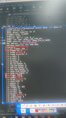

xuweilai
xuweilai_0-1728641187952.jpegxuweilai_0-1728641187952.jpegxuweilai_1-1728641197535.jpegxuweilai_1-1728641197535.jpeg
@yipingwang  I am trapped with this bus for a long time,could you help me ?
dpmac increase with rx frags when host pinging 2160, but dpni could not get data from dpmac.17
