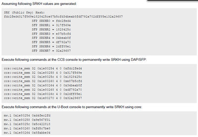

Yes, according to
6.1.1.5.2.2 Byte swap for reading and writing SRKH/OTPMK
You should write to OTPMK and SRKH considering the core endianness and using u-boot, it is correct that the bytes should be swapped.
Look at the example provided for the guide, if the generated keys were given using the commands for generating them, you are swapping your bytes correctly and putting them into the correct register.
Also, the OTPMK is generated correctly, the same goes for the SRKH generation.
