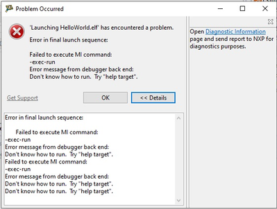

When I attempt to debug the HelloWorld sample project, I get this:
What does this mean, and how do I fix it?

yipingwang
Please click "flash programing icon" under "Target Connections" to flash programing directly.
The flash programming algorithm runs in OCRAM.
Probably DDR initialization section provided in CW initialization file is not suitable for your target board.

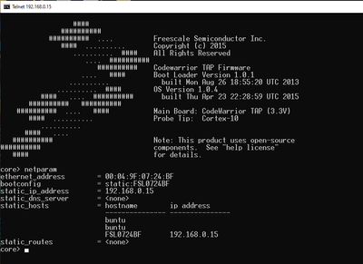

Also, using a terminal window, and telnet, the communication to the TAP module looks like this:

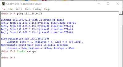

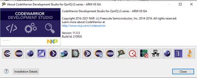

I uninstalled my current installation of Codewarrior, and downloaded the files you recommended above.  After installation of both CodeWarrior and the updates, my system looks like this:
Creating a bare metal project, and compiling, was successful.

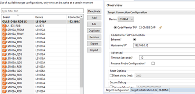

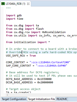

Replicating the Target Connection, assigning an IP address, and modifying the Target Initialization file to reflect USE_SAFE_RCW = True was also successful, as shown here:

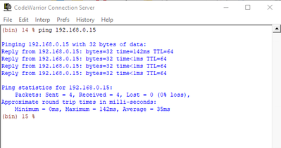

Pinging the TAP module is successful, as shown here:
Device Manager shows TAP device, as shown here:
Even the CCS utility pings the device, as shown here:
However...
The CCS utility cannot find the TAP module:

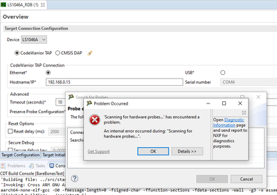

Nor can CodeWarrior:
And I still am getting this "Problem Occurred" window.

  1. Please refer to section "3.2 Working with bareboard application" in C:\Freescale\CW4NET_v2020.06\CW_ARMv8\ARMv8\Help\Getting_Started_for_CW_ARMv8.pdf to create a bareboard project in CodeWarrior IDE to connect to the target board.
Please enable hard-coded RCW in CodeWarrior initialization file.
In Target Connections panel, please double click LS1046A_RDB(1) to open "Target Initialization File" panel, please modify "USE_SAFE_RCW = False" to "USE_SAFE_RCW = True", then save the configuration and connect to the target board.

Failure during attempted debug session indicates:
Warning:
Cannot insert breakpoint 1.
Cannot access memory at address 0x80000d28
Does this mean the debugger is attempting to load the software into DDR memory and execute from there?
Where is the DDR configured within the bareboard example?
