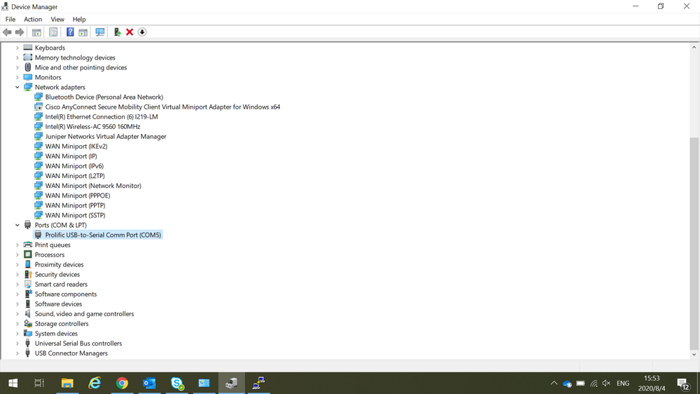

Please check whether the USB to Serial port displayed as the following in device manager.

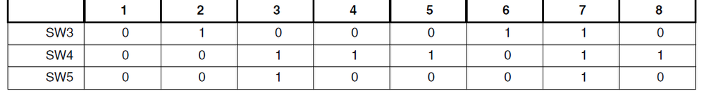

Please check the switch setting as the following.

Right, that's what's happening: no USB-to-serial device shows up on the USB device tree--and thus nothing under the "Ports (COM & LPT)" gets added--and the DIP switches are all in the proper positions, including SW4[4].  Clearly the mbed device is working enough to expose the bootloader storage, but nothing else.

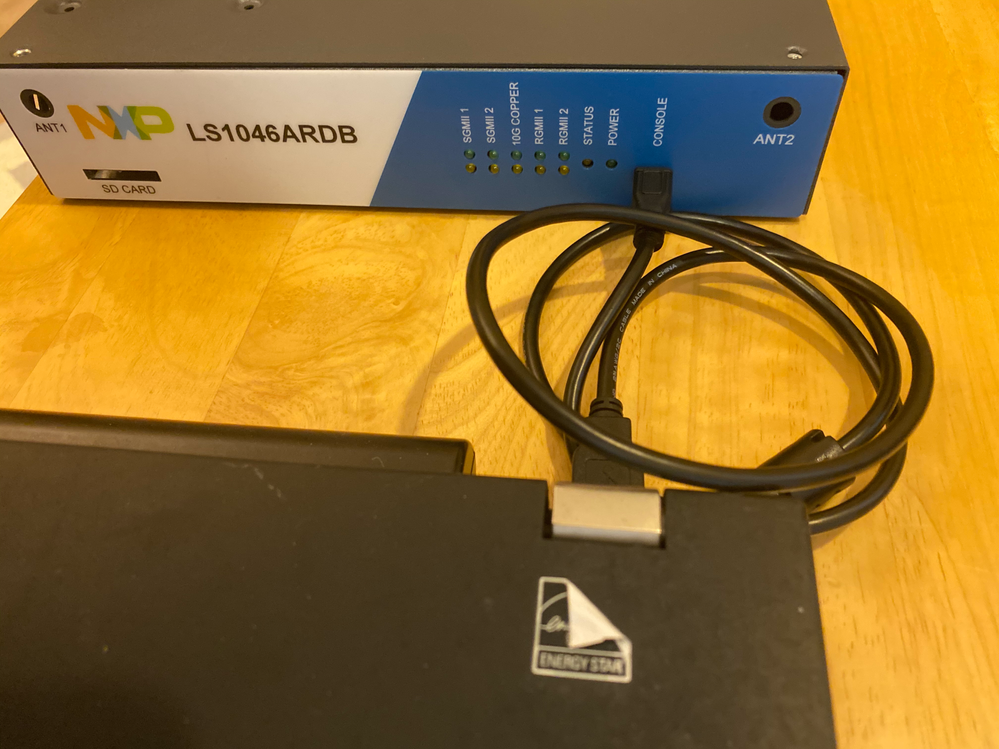

Would you please attach a picture to show what cable do you use to connect your target board and PC?

jepstein
For what it's worth, the UART1 connection does work (and we did remember to put SW4[4] back), so I suspect it's an odd mbed issue.
13,413 Views
yipingwang
Probably there is problem with the your serial cable, after plugin the serial cable to the PC, you should find the serial port information under ports(COM & LPT) in the device manager.
In addition, please set the switch configuration same as my target board.
SW3: 01001110
SW4: 00101011
SW5: 00100000
