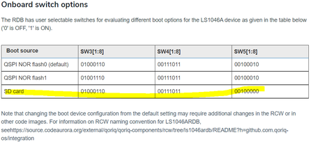

I am following the instructions at [1] to download and deploy composite firmware to an SD card from Windows. After I insert the SD card into the LS1046ARDB and boot into TinyLinux, I am able to run
"flex-installer -i auto -m ls1046ardb -d /dev/mmcblk0"
according to [2] to download and deploy the rest of the LSDK image. The output reads "Installation Successful" [3]. From there I can view the Ubuntu userland rootfs in /mnt/mmcblk0p4. But when I flip the DIP switches on the LS1046ARDB to boot from the SD card and reboot, I lose access to the serial console and it never comes back until I return the DIP switches to QSPI boot mode.
Why is the LS1046ARDB failing to boot Ubuntu userland from the SD card? Do I need additional changes in the RCW to boot from SD? I'm not sure what those would be.

Hi Em31,
I believe the issue to be that the LS1046ARDB uses a different partition table than the one linked in the Download and Deploy LSDK Composite Firmware in Windows instructions.
With a clean SD card, insert it into the LS1046ARDB.
Connect to the internet: udhcpc -i <interface>
Download and deploy LSDK (takes a long time, wait ~1hr): flex-installer -i auto -m ls1046ardb -d /dev/mmcblk0 -p 4P=128M:2G:8G:-1
Power off, flip the DIP switches to SD boot mode, and power-on.
You should boot right into the promised Ubuntu userland.
