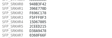

Hoping to get some insight into why I might be getting this error.
The Following is the output from the build of the header:
/home/dmerrill/projects/hardware/bsp/build/tmp-glibc/work/ls1046ardb-oe-linux/atf/git-r0/recipe-sysroot-native/usr/bin/cst/create_hdr_isbc --in /home/dmerrill/devtool-workspace/atf/build/ls1046ardb/debug/bl2.bin --out /home/dmerrill/devtool-workspace/atf/build/ls1046ardb/debug/hdr_bl2 drivers/nxp/auth/csf_hdr_parser/input_bl2_ch2 --verbose
EL3 Runtime Firmware BL31: offset=0x88, size=0xF63D, cmdline="--soc-fw"
Non-Trusted Firmware BL33: offset=0xF6C5, size=0xD1436, cmdline="--nt-fw"
#------- CST (Code Signing Tool) Version 2.0 -------#
file name is /home/dmerrill/devtool-workspace/atf/build/ls1046ardb/debug/bl2.bin
file name is /home/dmerrill/devtool-workspace/atf/build/ls1046ardb/debug/hdr_bl2
?? getopt returned character code 00 ??
This tool includes software developed by OpenSSL Project
for use in the OpenSSL Toolkit (http://www.openssl.org/)
This product includes cryptographic software written by
Eric Young ([email protected])
Input File is drivers/nxp/auth/csf_hdr_parser/input_bl2_ch2
- Dumping the Header Fields
- SRK Information
- SRK Offset : 200
- SRK Flag = 1
- Number of Keys : 1
- Key Select : 1
- Key List :
- Key1 srk.pub(100)
- UID Information
- UID Flags = 00
- FSL UID = 00000000_00000000
- OEM UID = 00000000_00000000
- FLAGS Information
- Secondary Image = 0
- Manufacturing Protection = 1
- Image Information
- SG Table Offset : 800
- Number of entries : 1
- Entry Point : 10000000
- Entry 1 : /home/dmerrill/devtool-workspace/atf/build/ls1046ardb/debug/bl2.bin (Size = 000102ea src=10000000 DST = ffffffff)
- RSA Signature Information
- RSA Offset : a00
- RSA Size : 80
Image Hash:
71b7fe65ee12a5da6555048a48871ad81c5a0b9d1e93a0421a6245d7a32886cb
* Header File is with Signature appended
Header File Created: /home/dmerrill/devtool-workspace/atf/build/ls1046ardb/debug/hdr_bl2
SRK (Public Key) Hash:
948b3f42396e770df696c178f5fff0f315d678052ceed215d38a94780360f66f
SFP SRKHR0 = 948b3f42
SFP SRKHR1 = 396e770d
SFP SRKHR2 = f696c178
SFP SRKHR3 = f5fff0f3
SFP SRKHR4 = 15d67805
SFP SRKHR5 = 2ceed215
SFP SRKHR6 = d38a9478
SFP SRKHR7 = 0360f66f
The bl2 is programmed into qspi and the srkh registers are programmed during boot hold off with the values as show in the attached image:
Boot is released, however once boot reaches BL2 it is set to non secure and SRATCHRW2 is set to 0x341. I can't figure out what about the signature is invalid. Any help would be appreciated. Thanks.

yipingwang
ISBC validation error codes
0x341 ERROR_HASH_COMPARE_EM RSA
signature check failure. Signature provided by you in
the header doesn’t match with the signature of the ESBC
image generated by ISBC. The ESBC image loaded by you
may be different than the image used while generating the
signature(using CST)
I notice in your build log image hash is printed as the following.
Image Hash:
However SRK is as the following.
Please refer to the following command to build secure ATF image.
make -s -j2 fip pbl PLAT=ls1046ardb BOOT_MODE=qspi RCW=/home/nxa22585/data/flexbuild_lsdk2108_bak/build/firmware/rcw/ls1046ardb/RR_FFSSPPPH_1133_5559/rcw_1600_qspiboot_sben.bin BL33=/home/nxa22585/data/flexbuild_lsdk2108_bak/build/firmware/u-boot/ls1046ardb/uboot_ls1046ardb_tfa_SECURE_BOOT.bin TRUSTED_BOARD_BOOT=1 CST_DIR=/home/nxa22585/data/flexbuild_lsdk2108_bak/components/apps/security/cst

yipingwang
As in the LSDK UG, error code 0x341 has the following ISBC error definition:
RSA signature check failure. Signature provided by you in the header doesn’t match with the signature of the ESBC image generated by ISBC. The ESBC image loaded by you may be different than the image used while generating the signature(using CST)
What it is complain about is the "signature" of your signed image in flash media, does not match the run time calculation of the image you are trying to boot. As you can see in
https://docs.nxp.com/bundle/GUID-487B2E69-BB19-42CB-AC38-7EF18C0FE3AE/page/GUID-4D5D0916-29CC-4E11-B...
The CSF header contains:
0x0c RSA signature offset
This field contains an offset (in bytes) of the RSA signature from the start of the CSF header. Using this offset and the signature length, the RSA signature is read. The RSA signature is calculated over CSF header, SG table, and ESBC images.
0x10 RSA signature length in bytes.
The RSA signature does not match the run time calculation.
i.e.
https://docs.nxp.com/bundle/GUID-487B2E69-BB19-42CB-AC38-7EF18C0FE3AE/page/GUID-0D3D0BD8-45E2-4D2D-B...
Assuming that the device is configured to perform secure boot, the digital signature validation routine performs following steps (as shown at the right side of the figure).
The routine locates and parses the CSF header to determine the size and location of the image, public keys, and digital signature.
It hashes the public key and compares it to the hash of the public key or key list stored in the SRKH register in SFP. If the hash comparison fails, secure boot fails.
It uses the validated public key to decrypt the digital signature, recovering the hash of the header + image + public keys.
The routine then calculates hash over the header + image (ESBC/Trusted Firmware) + public keys and compares the decrypted hash to the calculated hash. If the hash comparison fails, the secure boot fails.
The ISBC uses the validated public key to decrypt the digital signature, recovering the hash of the header + image + public keys. The ISBC then calculates a hash over the header + image (ESBC/Trusted Firmware) + public keys and compares the decrypted hash to the calculated hash. If the hash comparison fails, secure boot fails.
The ISBC is using a SHA256 to calculate the signature. Can you check your CSF header (or provide the CSF to us to investigation)0x0C and 0x10 pointer has the correct information in the LS1046A? Also the CSF header "0x04 Public key offset" points to a corrected public key?
Lastly, what flash media you are using for secure boot (i.e. NOR, NAND, SD)? How you build the signed image?
Have you tried LSDK2108, "bld -m ls1046ardb -b sd -s" to build? i.e. "-s" option for secure boot.

So another datapoint that hopefully will help. I went ahead and followed the steps for flashing from here https://docs.nxp.com/bundle/GUID-487B2E69-BB19-42CB-AC38-7EF18C0FE3AE/page/GUID-853E743B-D814-4DBF-B... using
firmware_ls1046ardb_qspiboot_secure.img
instead of the non secure like the docs suggest. I reboot to the alt flash bank and attach and set my srkh mirror registers and still end up with the 0x341 error code and non-secure. So seems this isn't an issue with my build since its happening with a build directly from nxp as well? Thoughts?
7,635 Views

If you are using a pre-built image from us. you have to use our SRKH value. how do you program that? Can you share your CCS console log?
additional info using pre-build image.
In the pre-build image, there should be a srk_hash.txt.
For example:
Input File is input_files/uni_sign/lx2160/input_bootscript_secure
2ff8750dee453269d43bfc6ca38ec315468e2fad73f157f21b383707a8c48e0e
SFP SRKHR0 = 2ff8750d
SFP SRKHR1 = ee453269
SFP SRKHR2 = d43bfc6c
SFP SRKHR3 = a38ec315
SFP SRKHR4 = 468e2fad
SFP SRKHR5 = 73f157f2
SFP SRKHR6 = 1b383707
SFP SRKHR7 = a8c48e0e
If they are using CWTap to write to the SRKH mirror register, there is no need to do endianess swap for the above value.

Additionally I installed the qspi_boot_sec.pbl that was generated by the lsdk using flex-builder -i mkfw -m ls1046ardb -b qspi -s and inputing the hash into the srkh registers and I still get 0x341 signature error.
8,200 Views
dmerrill
Any ideas on what to look at here or more information that could point out what is wrong would be greatly appreciated.
