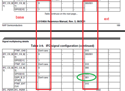

Since I wasn't going to accept that answer, I spend a few days playing around with things, and finally got it to work - key note for anyone reading this:  The reference manual is wrong.  Don't believe the RCW settings table 3-9 for IFC signal configurations:
When IFC_GRP_E_EXT is set to 1, the RD_B[n]_B signal associated with IFC_CS_B[1] is ignored!  This is the problem.
Set IFC_GRP_E_EXT to 0 and watch what happens!

Note:  I'm not using CS[2], only CS[0] and CS[1], so I didn't think this mattered... but it does...

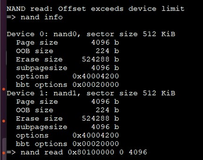

Here are the results while using the u-boot commands:
NAND read: device 0 offset 0x7ff80000, size 0x80000
 524288 bytes read: OK
=> nand read 0x80100000 0x80000000 0x80000
NAND read: device 0 offset 0x80000000, size 0x80000

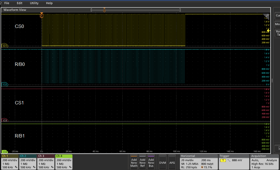

As a background on the board, the NAND flash is 4GB; 2GB per chip select.
I am able to control the CS lines independently when I use the following code

I get the following scope traces:
NAND CS1&2NAND CS1&2
The problem is from within u-boot.  When I execute `nand erase.chip`, the terminal output indicates it erases all addresses from 0x00000000-0xFFFFFFFF, but the scope indicates it never uses the CS1 line...  this is confusing.
Can you think of a reason why this might happen?
