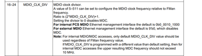

"This parameter is dependent on the Ethernet clock frequency. The MDIO_CFG[MDIO_CLK_DIV] field determines the clock frequency of the MgmtClk Clock EC_MDC."
Referring to the information located on 6.4.3.4.1 MDIO Configuration Register (MDIO_CFG) from the QorIQ LS1046A Data Path Acceleration Architecture (DPAA) Reference Manual, Rev. 0 at field "MDIO_CLK_DIV"
For internal MDIO/MDC accesses, only default MDIO_CLK_DIV value should be used regardless of FMan frequency value. If MDIO_CLK_DIV is programmed with a different value than default setting, then for internal MDC accesses the upper resulting MDC frequency should not exceed 10 MHz
Regarding your questions:
Due to this information, I would like to confirm you that such signal should not exceed 10Mhz.
