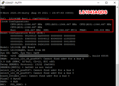

I generated the SD boot with the LSDK version lsdk2012, but the figure 1 below shows the baud rate was changed when it ran to BL31. The baud rate is correctly output at 115200 before BL31, then I measured the waveform it became 178000 after BL31. The figure 2 below shows the clock configuration data is incorrect.(The correct clock configuration is figure 3.) Is there anything I can modify?

After I modified as you suggested, the baud rate value measured became to around 12M and it's over UART spec to output data.
Then I modified “#define CONFIG_SYS_NS16550_CLK 115200” to “#define CONFIG_SYS_NS16550_CLK (get_serial_clock())” , the baud rate retrieved 178000.
 I think the root cause is the core frequency is changed from 1600MHz to 1066MHz to affect the baud rate.
How to correct the core frequency to 1600MHz?

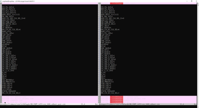

Please run the following command to get the difference.
vimdiff packages/firmware/rcw/ls1043aqds/RR_FQPP_1455/rcw_1600_sdboot_qspi.rcw packages/firmware/rcw/ls1043ardb/RR_FQPP_1455/rcw_1600_sdboot.rcw
rcw_1600_sdboot_qspi.rcw enables QSPI in SD boot.
rcw_1600_sdboot.rcw enables IFC in SD boot.
6,524件の閲覧回数
Might-Lee
The result below shows no difference.
