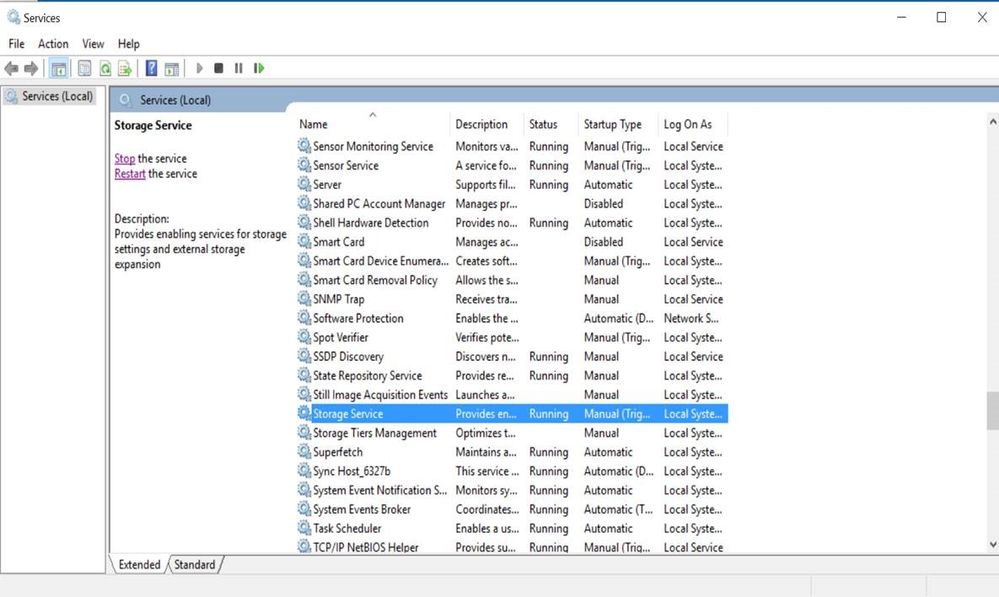

Also, there is a known issue with MBED operation under Win10.
This is the work around we have confirmed to fix the mbed issue on Win10 PC's:
- Go to the "Start" option on the PC and type the command  "Services"
- Than you should see the following "Services" window open
- Select the "Storage Services" and on the left-hand side of the window click the "Stop the service"
