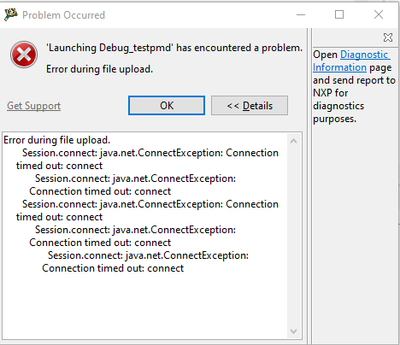

smruthi_ramesh
I tried that and am getting the following error:
I tried to ssh into the IP address but it gave a connection timeout error.
8,131 Views
yipingwang
Which version SDK/LSDK are you using on the target board?
How do you boot up the target board? Would you please provide the whole console log booting up the target board?

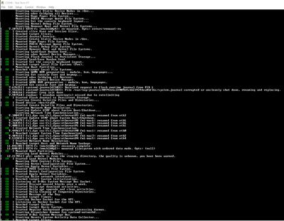

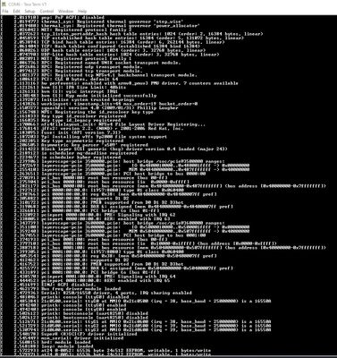

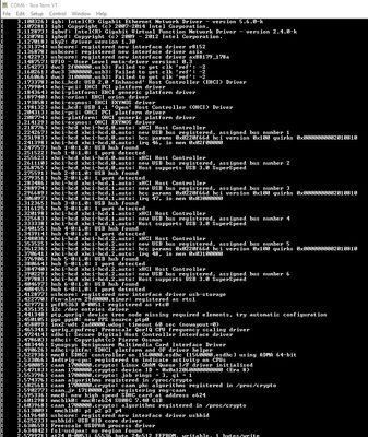

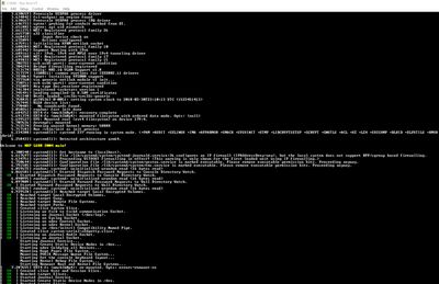

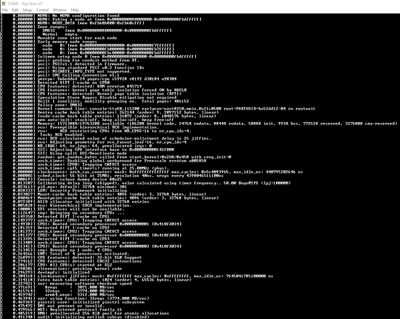

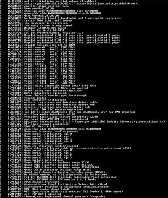

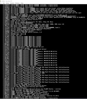

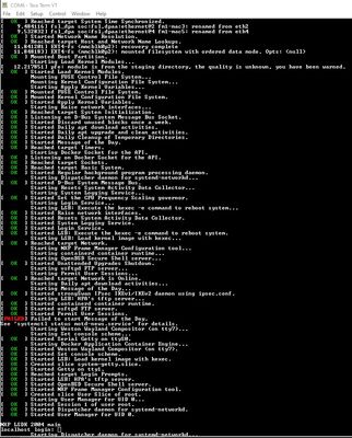

smruthi_ramesh
I am using LSDK 2004. I am booting the board with an SD card that has the LSDK 2004 version
I am attaching screenshots of the boot log.
8,079 Views
yipingwang
In USDPAA dts file fsl-ls1043a-rdb-usdpaa.dts, all Ethernet ports have been assigned to DPDK, you need to delete one Ethernet port definition in the dts file to assign it to Linux Kernel.
