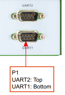

1.as you mentioned you used a DP-DP cable to connect the monitor?Which port do you used on the board?UART2?
2. Does that means the openil can only be displayed by this method?
Thanks a lot.
2,860 Views
andrejk
Not sure how this correlates, but UART1. There were multiple issues I had toworkaround, including - DP-HDMI is apparently not supported (out-of-box) with LSDK 19.09 - instead 'i2c mw ox66 0x54 0x0' has to be done to enable power to DP_PWR. That's fixed in LSDK 20.04 uboot. Then HDP firmware has to match the linux driver and it seems to work...
