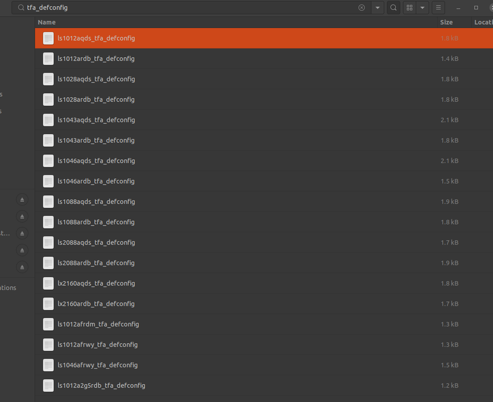

I am trying to implement Secure Boot + Chain of Trust w/Confidentiality. I am following the steps outlined in Section 6.1.4: Procedure to enable Secure Boot in the LSDK User Guide Rev 19.09_311219.
I have built the CST and generated keys and built the LSDK composite secure boot firmware. I am now on Step 4: Generate Fuse Provisioning Firmware. This links me to Section 6.4.4 in the user guide. In Step 3: Generate BL31 image with fuse provisioning support, it says to run the following command:
   flex-builder -c atf -m <machine> -b <boottype>
so I run:
   flex-builder -c atf -m ls1021atwr -b sd
and I get the following output:
root@538bbf29aa5d:/flexbuild# flex-builder -c atf -m ls1021atwr -b sd
COMPONENT: atf
MACHINE: ls1021atwr
BOOTTYPE: sd
make: Entering directory '/flexbuild'
make[1]: Entering directory '/flexbuild/packages/firmware'
Building ATF ...
Building dependent fuse_scr.bin ...
 #------- CST (Code Signing Tool) Version 2.0 -------#
This tool includes software developed by OpenSSL Project
for use in the OpenSSL Toolkit (http://www.openssl.org/)
This product includes cryptographic software written by
Eric Young ([email protected])
Input File is input_files/gen_fusescr/ls2088_1088/input_fuse_file
building dependent /flexbuild/build/firmware/u-boot/ls1021atwr/uboot_ls1021atwr_tfa.bin ...
 Please add the dependent /flexbuild/packages/firmware/u-boot/configs/ls1021atwr_tfa_defconfig
make[1]: Leaving directory '/flexbuild/packages/firmware'
make: Leaving directory '/flexbuild'
Inside of the directory: /flexbuild/packages/firmware/u-boot/configs/, I see the following *_tfa_defconfig files:
please advise

Fuse provisioning firmware requires ATF which is not supported for your
platform/board:
https://docs.nxp.com/bundle/GUID-51EEFEDB-ABD5-40C0-BEBD-6527B3494D57/page/GUID-6FC46949-7E0C-47FE-A...
Secure boot is supported, but you have to program all necessary fuses by hand,
using Code Warrior or u-Boot:
https://docs.nxp.com/bundle/GUID-51EEFEDB-ABD5-40C0-BEBD-6527B3494D57/page/GUID-27FC40AD-3321-4A82-B...
https://docs.nxp.com/bundle/GUID-51EEFEDB-ABD5-40C0-BEBD-6527B3494D57/page/GUID-F54AA72B-FC4B-4F9A-8...
