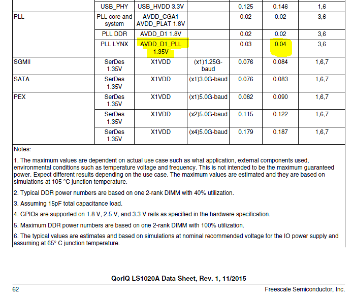

6) Could you please confirm that the power draw highlighted in yellow in the attached is the total power drawn by both the AVDD_SD1_PLL1/2 pins, and not per PLL pin.PLL_Power.PNG

  1. 6. It is power consumption of PLL. It is not current from PLL pins.
