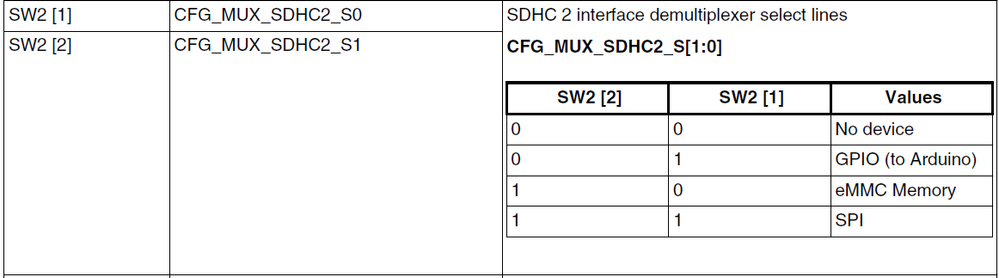

I try to free up both USB and SD card slots for other purpose.
For the moment I use QSPI for firmware (default way) and an external USB stick for boot partition and rfs.
I'd like to put now all firmware, boot partition and rfs on the embedded eMMC, it looks like big enough (4G).

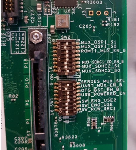

My problem now is that when in u-boot stage, i cannot see any eMMC memory.
Of course correct set switches as this:
Also tried and did several mmc rescan and such commands in u-boot but device does not show up.
Started looking into u-boot configuration files since I simply did standard build using "flex-builder -m ls1012ardb" command and got all binaries done (here firmware for instance).
What am I missing? Do I need to rebuild my firmware or pass some special arguments in u-boot to see eMMC?
And: is my goal of putting firmware, bootloader and rfs all onto same eMMC memory device correct approach?
Thx Christophe

yipingwang
Hello Christophe SCHMID ,
Please refer to the switch setting for EMMC.
Yiping

christophe_schm
Hello yipingwang
Maybe my question was not clear enough, sorry. Of course I already correctly set the switches as said in documents.
Here a pic of my board.
Thx Christophe

yipingwang
EMMC
Need to switch sw2[1,2]=01
And run the command of "mmc dev 1" to switch emmc mode in uboot
After Rev D board, the HW for board had some upgrtaded, so need to set the hwconfig in uboot to support the emmc and then run "mmc dev 1", and linux will to support the EMMC
setenv hwconfig esdhc1
17,434 Views
christophe_schm
Hello yipingwang‌,
Ok that worked, thanks! I now can see this (both QSPI booted TinyLinux and regular Linux still being on my USB stick)
