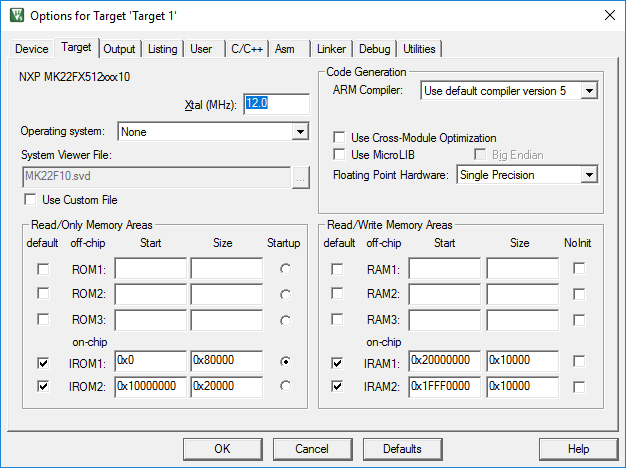

Problem: both RDBs got their K22 based CMSIS DAP bootloader bricked after having worked for a few days like a charm with CodeWarrior IDE.
I now try since ~1 week to reflash a new bootloader into the K22 of this QorIQ platform.

I also managed to get full DAPLink sources to rebuild my bootloader from scratch and flashing it using our MDK Pro IDE latest version + UlinkPro probes: DAPLink/DEVELOPERS-GUIDE.md at master · ARMmbed/DAPLink · GitHub
Both approaches described above give same result: either K22 does not boot correctly or boots but USB device is not recognized by my WIN10 host. Remind: my goal is to first get BOOTLOADER MSC back so I can then simply drop into it the new DAPLink application binary - so far my bootloader remains silent. I am now convinced I use both wrong binaries and / or sources - I must get those not from Kinetis folks but from QorIQ folks here, agree.

This comes as a BIN I first had to transform into a HEX so my MDK Pro + UlinkPro setup is able to flash it into the K22 target using latest srec_cat tool:
srec_cat.exe k22fx512_if_mbed.bin -binary -o k22fx512_if_mbed.hex -intel
My KEIL uVision project has correct packages and all is configured well, flash process terminates without error (checked the logs too). Confirm my K22 MCU is exactly this one: MK22FX512AVLH12
So here I am, what do I wrong? Is there a more recent binary I could get from QorIQ team that will not brick when connecting to WIN10 host? Our company only uses WIN10, I cannot change that. May sources so I rebuild the bootloader and OpenSDA or DAPLink on top as well? I saw on this link DAPLink/DEVELOPERS-GUIDE.md at master · ARMmbed/DAPLink · GitHub  that the projects.yaml file does not cover the very MCU used here but only k20dx_frdmk22f_if.

I did the "Storage Services" stop already and it worked in the past. So I don't think this is the problem now. I also retried to renable, disable it again, nothing changes, still the same: debug probe is dead.
Doing your three steps: LED D22 is and remains OFF, nothing happens even not a single blink, also after releasing the reset button once connected the USB cable into the CSAM USB.
I flashed the BIN you provided me already: k22fx512_if_mbed.hex (had to transform it BIN-->HEX first using srec_cat.exe).

Please read section 4 in the provided document to understand that the image should be copied into 'BOOTLOADER' and not transformed to HEX and programmed.

  • k22fx512_if_mbed.bin your provided to me is then NOT the bootloader but the application code/firmware, my bad
  • I cannot flash *.bin files with MDK Pro + UlinkPro JTAG probe (mainly only HEX and ELF and some other formats work)
  • I don't have any BOOTLOADER showing up anymore on my WIN10 host machine because bootloader must be broken
Conclusion: I need another binary, sources that brings me first back my BOOTLOADER, then I can can indeed drop k22fx512_if_mbed.bin into BOOTLOADER, understood that.
