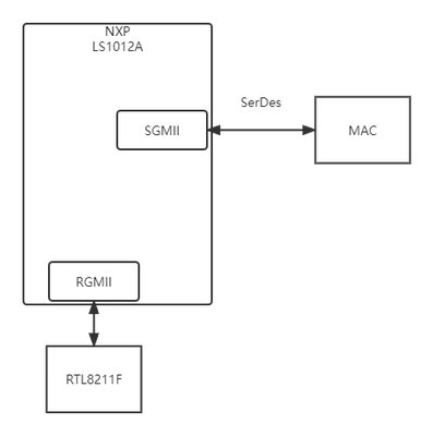

HI, team:
Below is my hardware design, My lsdk version is lsdk 2108
My dts is as below:
&pfe {
	status = "okay";
	#address-cells = <1>;
	#size-cells = <0>;
	pfe_mac0: ethernet@0 {
                compatible = "fsl,pfe-gemac-port";
                #size-cells = <0>;
                reg = <0x0>;    /* GEM_ID */
                fsl,gemac-bus-id = <0x0>; /* BUS_ID */
                /*fsl,gemac-phy-id = <0x2>;  PHY_ID */
                fixed-link = <0 1 1000 0 0>;
                fsl,mdio-mux-val = <0x0>;
                local-mac-address = [ 00 1A 2B 3C 4D 5E ];
                phy-mode = "sgmii";
                fsl,pfe-gemac-if-name = "eth0";
                fsl,pfe-phy-if-flags = <0x0>;
                fsl,pfe-gemac-mode = <0x1B00>; /* GEMAC_SW_CONF | GEMAC_SW_FULL_DUPLEX | GEMAC_SW_SPEED_1G */
                mdio@0 {
                        reg = <0x1>; /* enabled/disabled */
                        fsl,mdio-phy-mask = <0xFFFFFFF9>;
        pfe_mac1: ethernet@1 {
                #size-cells = <0>;
                reg = <0x1>;    /* GEM_ID */
                fsl,gemac-bus-id = < 0x1 >;
                fsl,gemac-phy-id = < 0x1 >;
                local-mac-address = [ 00 AA BB CC DD EE ];
                phy-mode = "rgmii-id";
                fsl,pfe-gemac-if-name = "eth1";
                mdio@0 {
                        reg = <0x0>; /* enabled/disabled */
After enter command: can't ping 192.168.0.1 successfully. Could you help to check and give suggestions?

Hugh512
Dear Chavira:
Thanks, based on your suggestions, I made below modifications and finally can ping gateway success.
diff --git a/drivers/net/phy/realtek.c b/drivers/net/phy/realtek.c
index 746cdfd06578..c0d27537cd54 100644
--- a/drivers/net/phy/realtek.c
+++ b/drivers/net/phy/realtek.c
@@ -749,6 +749,7 @@ module_phy_driver(realtek_drvs);
static const struct mdio_device_id __maybe_unused realtek_tbl[] = {
{ PHY_ID_MATCH_VENDOR(0x001cc800) },
+ { PHY_ID_MATCH_VENDOR(0x001cc916) },
before booting into linux, execute command "pfe stop" in uboot.
ifconfig eth1 192.168.0.110 up
ping 192.168.0.1
