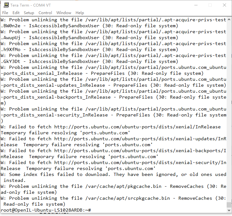

1. I used nxp_ls1028ardb-64b_ubuntu_defconfig of OpenIL, and programmed it into SD card. And I boot the board with root successfully, when I use command "apt-get update",(sudo is not avaliable) error occurs as shown in the following figure:

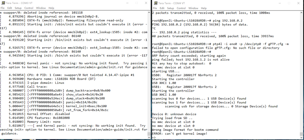

 2. Also, I tried OpenIL with baremeta framework and I insert SD card to board after compling os successfully, but error occurs as follows,
Note that left is UART1(COM3), right is UART2(COM4).

Are you using Openil 1.5 release?
Please refer to the attached log for "apt-get update", I used the images built from the latest release.

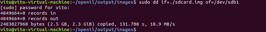

1. I have complie sdcard.img following document below successfully. (environment:ubuntu 18.04 LTS running as virtual machine in my windows pc)
2. the sdcard.img burn into the sd card successfully

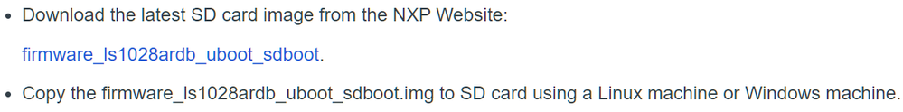

3. copy below file to sd card

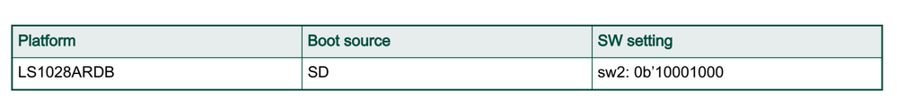

4. Insert the SD card into the LS1028ARDB, the DIP switch (SW2) set as manual shows.
