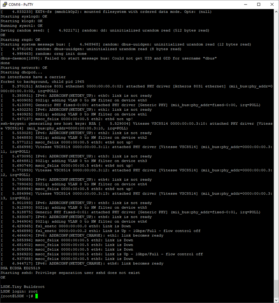

I'm using the LS1028ARDB with a SD card and the LSDKUG Rev20.04 document to develop the software. I used the flex-build to compile all the firmware, as shown in the document mentioned. However, I don't want to use the RAMdisk filesystem. Is there some argument or command on the bootloader that allow me to use a rootfs.ext4 filesystem (generated on buildroot) written in the same partition used to boot in a SD card? It is not a problem if the bootloader needs to create another partitions, but it is desirable that I don't need to do it externally (using Gparted).

Also, my problem is that apparently the filesystem mounted by the Kernel is in the RAM (included in the composite firmware passed in the argument -f of the flex-installer). I say this because the welcome message of the buildroot filesystem must be this, according the defconfig of the board (qoirq_arm64_tiny_defconfig on flex-builder configs/buildroot):
Not this:
I need that the Kernel mount the EXT4 partition where my buildroot rootfs was installed (argument -r of the flex-installer).  How can I make the Kernel mount the EXT4 partition instead of the RAMdisk filesystem on the composite firmware?

6,725 次查看
igor_franco
Hello Yiping,
Find boot log from the bootloader to the tiny rootfs login attach in this message.
Igor

You can notice that even my Kernel command inform that root=/dev/mmcblk0p4, the Kernel is using the RAMDisk. Usually, the logs show when a device is mounted as rootfs. There is nothing indicating that my parition 4 was mounted.
Also, I tested the filesystem by writing a file and rebooting the board, the file was not there, which is a behavior of a RAM filesystem.
Igor
