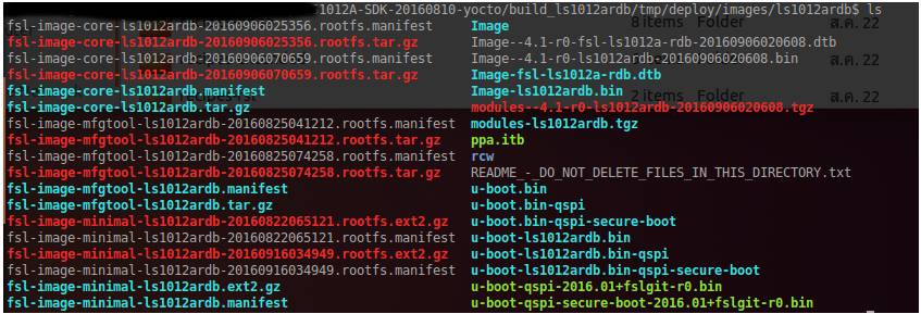

I tried follow your step but still doesn't have uImage at /tmp/deploy/image/.
just
Image -> Image--4.1-r0-ls1012ardb-20160906020608.bin

Look at attached file.
Do you have similar uImage file?

nattapongsungch
Yes , I also attached files.

Pavel
Use uImage*.bin file for your task.

nattapongsungch
You mean I can use Imag*.bin for boot instead of uImage  ? .
Because , In my folder doesn't image named uImage.
