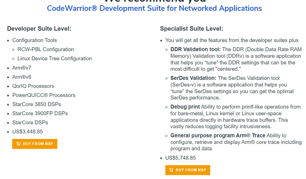

June_Lu
You could try to use flash programmer to program first image with CodeWarrior TAP if the eMMC on the board could be supported.
If the Tiny Linux is ready, using flex-installer will be recommended way.

NanWang
We have only eMMC on our customized board with LS1027A. We have following two questions to confirm:
1. According to our investigation, if we want to program LSDK BSP images including composite firmware, kernel and desktop rootfs on eMMC, we need to purchase NXP CodeWarrior software and hardware, but we find following two versions of CodeWarrior software, which version do we need to program eMMC on MP?
2. Can you provide us estimated programming time to program above three BSP images (size: about 1.5G) on eMMC through CodeWarrior software and CodeWarrior TAP hardware for reference?
