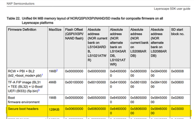

gandhi_999
Hi SebastianG,
Yes I have created OTPMK and SRKH.
Then after created secure headers for pbl (spl) and uboot using uni_sign from CST.
1. Now, how can I embed these headers in a respective image for secure boot?
2. Or Should I flash these separate headers in MMC (boot mode is eMMC) as uni_sign is generating a separate header? if yes please share SD card block location for the same.
6,405 Views
SebastianG
Hello @gandhi_999,
Regarding to the question "2. Or Should I flash these separate headers in MMC (boot mode is eMMC) as uni_sign is generating a separate header? if yes please share SD card block location for the same."
Please check LSDK 21.08 document on the page 181 as you can see in the following image:
Table 22. Unified 64 MiB memory layout of NOR/QSPI/XSPI/NAND/SD media for composite firmware on all Layerscape platforms Secure boot headers, SD block start: 0x03000
Sebastian
