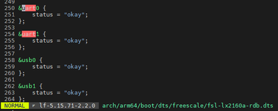

I'd like to enable both UART1 and UARAT2 in Linux on LX2160A.
kernel version: 5.15.71
configuration in dts, it seems ok.
Check UART control register, UART2 has not been enabled.
root@localhost:~# devmem2 0x21d0030 32
0x00000300
root@localhost:~# devmem2 0x21c0030 32
0x00000B01
May i have your comments?
Many thanks!
Zhao

Please try below patch
https://patchwork.ozlabs.org/project/uboot/cover/1607490724-6447-1-git-send-email-vabhav.sharma@oss....
Then enable CONFIG_SERIAL_PROBE_ALL=y in lx2160ardb_tfa_defconfig after applying this patch.

I checked the patch, it's about u-boot.
Does it mean enable UART2 in Linux should probe all UARTs in u-boot?
Zhao
5,458件の閲覧回数
yipingwang
Yes, you need to apply this patch in u-boot. Then check UART1 and UART2 in Linux.
5,456件の閲覧回数
ZhaoZheng1
That's make sense.
I just checked the patch already integrated into u-boot mainline at least in LF-5.15.y.
5,445件の閲覧回数
yipingwang
Please enable CONFIG_SERIAL_PROBE_ALL=y in lx2160ardb_tfa_defconfig after applying this patch.
We have verified this method in LSDK 21.08.
