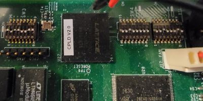

My switch settings are as you mention.

Configure the switch setting boot from SD card
               SW3[1:8]     SW4[1:8]       SW5[1:8]
SD card 10110011      00100000     00100010
