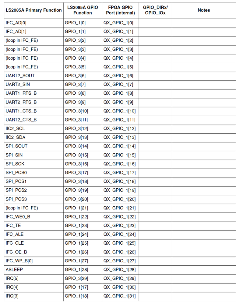

yipingwang
Hello naveen nvn,
The LS2085A has no dedicated GPIO pins. Instead, GPIO functions are multiplexed internally with other
signals, which must be disabled before using the GPIO functions. Additional set up may be required if pin with GPIO functions is used for board purposes.
To test GPIO, set the DUT to GPIO mode on selected pins, as shown in Table 2-42 and enable the
complimentary function within the FPGA.
GPIO Output:
Set the DUT to GPIO output mode on selected pins, as shown in following table.
Program the FPGA to input mode.
Observe that the DUT can control the FPGA.
GPIO Input:
Set the DUT to GPIO input mode on selected pins, as shown in following table.
Program the FPGA to output mode.
Yiping
