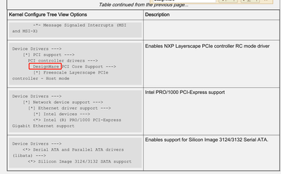

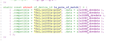

muaxi8
Contributor V
My RC mode is configured as shown below, So my driver should use "/drivers/pci/controller/DWC/pci-layerscapc.c",  But there is no information about "fsl, LX2160A-pcie" in the driver code;
