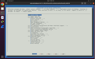

1 Custom the linux build

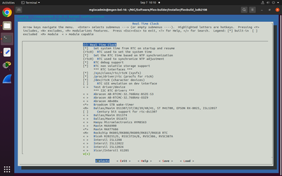

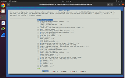

2. Select Device Driver -> RTC (Real Time Clock)
3 . Enable the following options as mention in Document
[*] Set system time from RTC on
startup and resume (new)
(rtc0) RTC used to set the system
time (new)
<[*] /sys/class/rtc/rtcN (sysfs)
<[*] /proc/driver/rtc (procfs for
rtc0)
<[*] /dev/rtcN (character devices)
4. Save the Config file

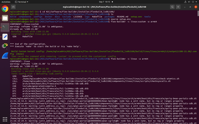

5. complie and build the boot file with custom config file
But i can't enable rtc time in custom build also .
