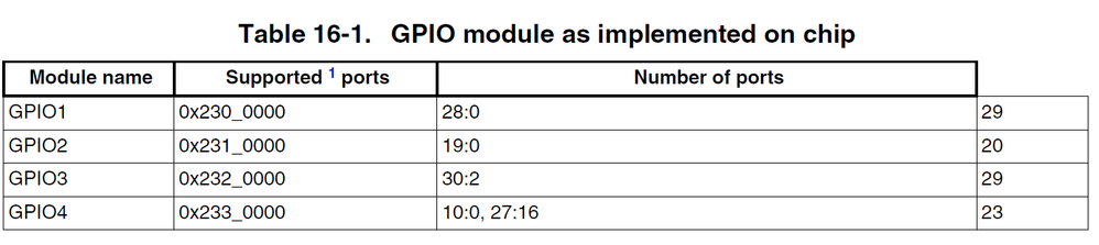

Hi Team,
We are using LSDK 18.09 for LS2088A custom board,
How we can add gpio in uboot dts and kernel dts to make gpio high and low. can we get example for this

LS2088 platform could use GPIO driver for PowerPC architecture. In Linux Kernel, please configure "CONFIG_ARCH_LAYERSCAPE=y" then configure "CONFIG_GPIO_MPC8XXX=y" in Linux Kernel configuration file and rebuild Kernel image.
GPIO has already been defined in Linux Kernel dts file as the following.

After boot up Linux system, you will get similar information as the following.
root@localhost:~# ls /sys/class/gpio/
export  gpiochip384  gpiochip416  gpiochip448  gpiochip480  unexport
root@localhost:~# cat /sys/kernel/debug/gpio
 GPIOs 384-415, parent: platform/2330000.gpio, 2330000.gpio:
GPIOs 416-447, parent: platform/2320000.gpio, 2320000.gpio:
GPIOs 448-479, parent: platform/2310000.gpio, 2310000.gpio:
GPIOs 480-511, parent: platform/2300000.gpio, 2300000.gpio:
GPIO424(416+8) corresponds with GPIO3_8, GPIO426(416+10) corresponds with GPIO3_10.
root@localhost:~# cd /sys/class/gpio/
root@localhost:/sys/class/gpio# echo 424 > export
root@localhost:/sys/class/gpio# echo 426 > export
root@localhost:/sys/class/gpio# ls
export  gpio424  gpio426  gpiochip384  gpiochip416  gpiochip448  gpiochip480  unexport
root@localhost:/sys/class/gpio# echo "out" > gpio424/direction
root@localhost:/sys/class/gpio# echo 1 > gpio424/value
root@localhost:/sys/class/gpio# ls gpio424/
active_low  device  direction  edge  subsystem  uevent  value
For more detailed information about GPIO on ARMv8 platforms, please refer to LS1043 GPIO support in Linux SDK .
