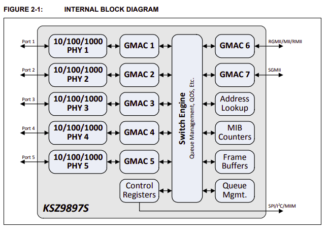

We am using ls1012a and ksz9897s, see below. We are connecting the GMAC 7 to mac 1(there are mac1 and mac2) on the ls1012a soc, so it's a MAC to MAC connection.
We are using SPI to manage this switch, not mdio. Also, only mac1 on ls1012a is used.  This is the PFE node in our device tree:

I deleted the mdio node, disabled the pfe_mac1, added the fixed-link for pfe_mac0.
Because we are connecting port 7(port@6 in the device tree) of the switch to mac1 on the ls1012a soc. In port 7 I configured ethernet=<&pfe>, also, added fixed-link.  I tried to configure etherent=<&pfe_mac0>,  but when I was trying to load the switch driver, it failed at dsa registering.
1. Is there any mistake in my pfe node, or the ethernet node. I deleted all mdio related configuration in the PFE node, is it right?
2. Is the connection configuration between ls1012a and switch correct?
3. Should I configure the pfe_mac0 as the SGMII MAC side, and the port 7 on the switch to be the PHY side? But the switch is not only a PHY device.
Any help? Than you!

Hello Kai Wu,
1. I reviewed the pfe device node, removing mdio related configuration is correct.
2. The MAC to MAC connection between between ls1012a and switch  is correct.
3. Please refer to Documentation/devicetree/bindings/net/dsa/ksz.txt, I consider ksz9897 configuration should be as the following.
ksz9897: ksz9897@0 {
             port@6 {
            reg = <6>;
            label = "cpu";
            ethernet = <&pfe_mac0>; //not sure about here, pfe or pfe_mac0
            fixed-link {
            speed = <1000>;
            full-duplex;
Yiping
