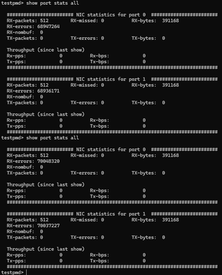

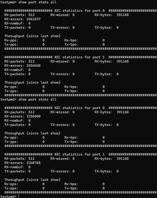

Does DPAA2 support packet capture based on
https://doc.dpdk.org/guides-22.03/tools/pdump.html?highlight=pdump, or
https://doc.dpdk.org/guides-22.03/tools/dumpcap.html?highlight=dumpcap ?
- 'dpdk-testpmd' + 'dpd-pdump'
after execution of dpdk-pdump, one new port will be added in testpmd.
dunk_3-1746702010669.pngdunk_3-1746702010669.pngdunk_4-1746702030247.pngdunk_4-1746702030247.png
'dpdk-testpmd' + dpdk-dumpcap'?
None of 2 ways above can capture packets.
My is DPDK repo: https://github.com/nxp-qoriq/dpdk.git, with tag 'la12xx-sdk3.1'.
