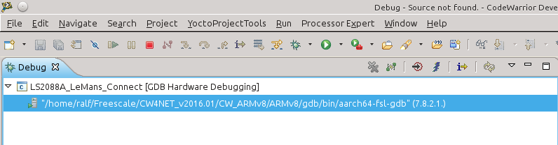

ralfgoebel
Hi Adrian,
I re-installed CW and added only LS2088 support.
With the steps you mentioned, I can connect to the target. But I don't have any runtime controls and the CPU seems to be running. I can only terminate the debug session:
I also tried to use 'USE_SAFE_RCW = True' within the Target Init File.
Using the LS2085A configuration with the RDB board works as expected: the CPU is haltet and the runtime controls are available.
Ralf
