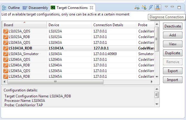

I use CodeWarrior TAP debug LS1043ARDB. But CodeWarrior TAP USB can't connect my compute.
My CodeWarrior  Development Studio configure as follows:
Errior log as follows:

ufedor
Please run "Diagnose Connection" and provide the log
2,322 Views
ufedor
Your version is not the latest.
Do you see v2017.03 in available CW downloads?
