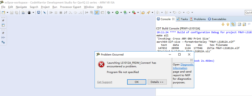

目前我们正在用FRDM-LS1012A做项目开发,怎么用codewarrior软件加载编译生成的目标码,按照V11.4.0版本对应的指导文档未涉及固件加载这一块,按照您之前的回复我找到了 CodeWarrior Development Studio for QorIQ LS series - ARM V8 ISA, Targeting Manual.这个文档里面的指导进行操作时文档中的一些界面图片指导和V11.4.0codewarrior界面中出现了不一样的情况无法进行继续操作,目前报了以下错误:error.PNG
用这个文档https://www.nxp.com/docs/en/user-guide/CWARMv8TM.pdf 中第7.1-7.2章节的指导进行操作时也报了错误,具体如下:

Release Notes for the CodeWarrior for QorIQ LS Series, ARMv8 ISA v11.4.0 can be downloaded from the same page -
CodeWarrior for QorIQ LS Series ARMv8 ISA. Evaluation / Updates. (https://nxp.flexnetoperations.com/control/frse/download?agree=Accept&element=10738487)
I've attached the document for your reference - see 4.1 Device Support Matrix.
The CodeWarrior Development Studio for QorIQ LS series - ARM V8 ISA, Targeting Manual is installed with the CodeWarrior and can be found in the folder: CW_ARMv8\ARMv8\Help\PDF\ARMv8_Targeting_Manual.pdf
10,963 Views
13540372905
From the document, we can see that there is a J11 port to debug LS1012A. Can we debug through this port instead of the emulator? If so, please kindly provide the document description
10,963 Views
ufedor
J11 provides CMSIS-DAP debug support.
The CMSIS Debug Access Port (CMSIS-DAP) can be selected during CodeWarrior Target Connection Configuration - refer to the CodeWarrior Development Studio for QorIQ LS series - ARM V8 ISA, Targeting Manual.
